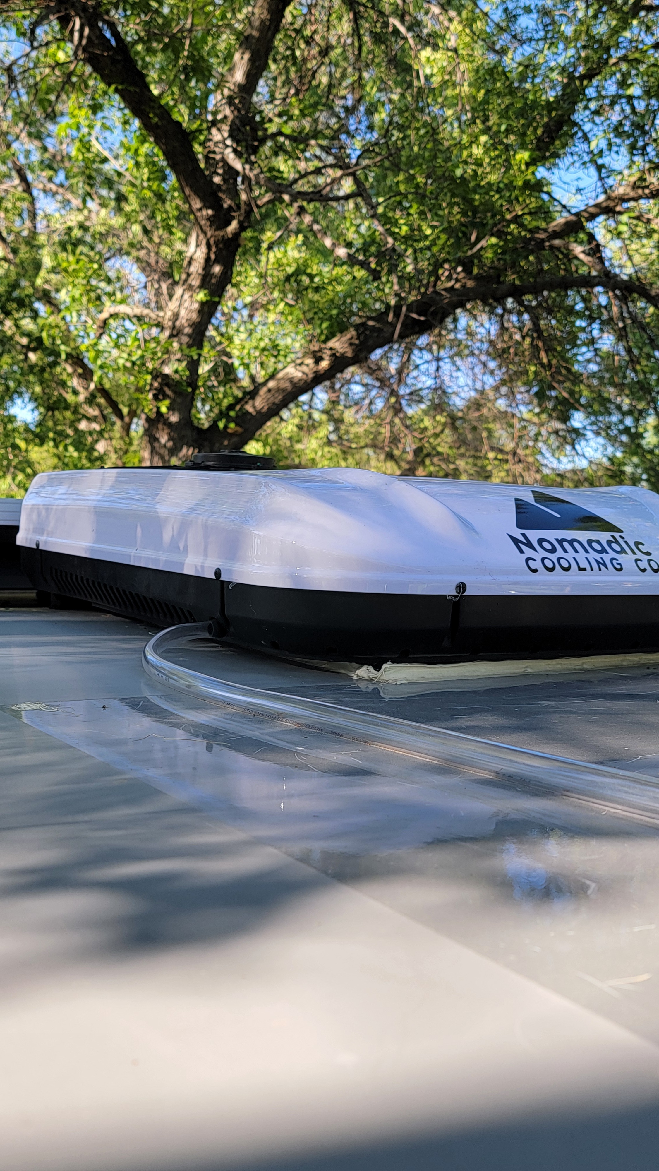

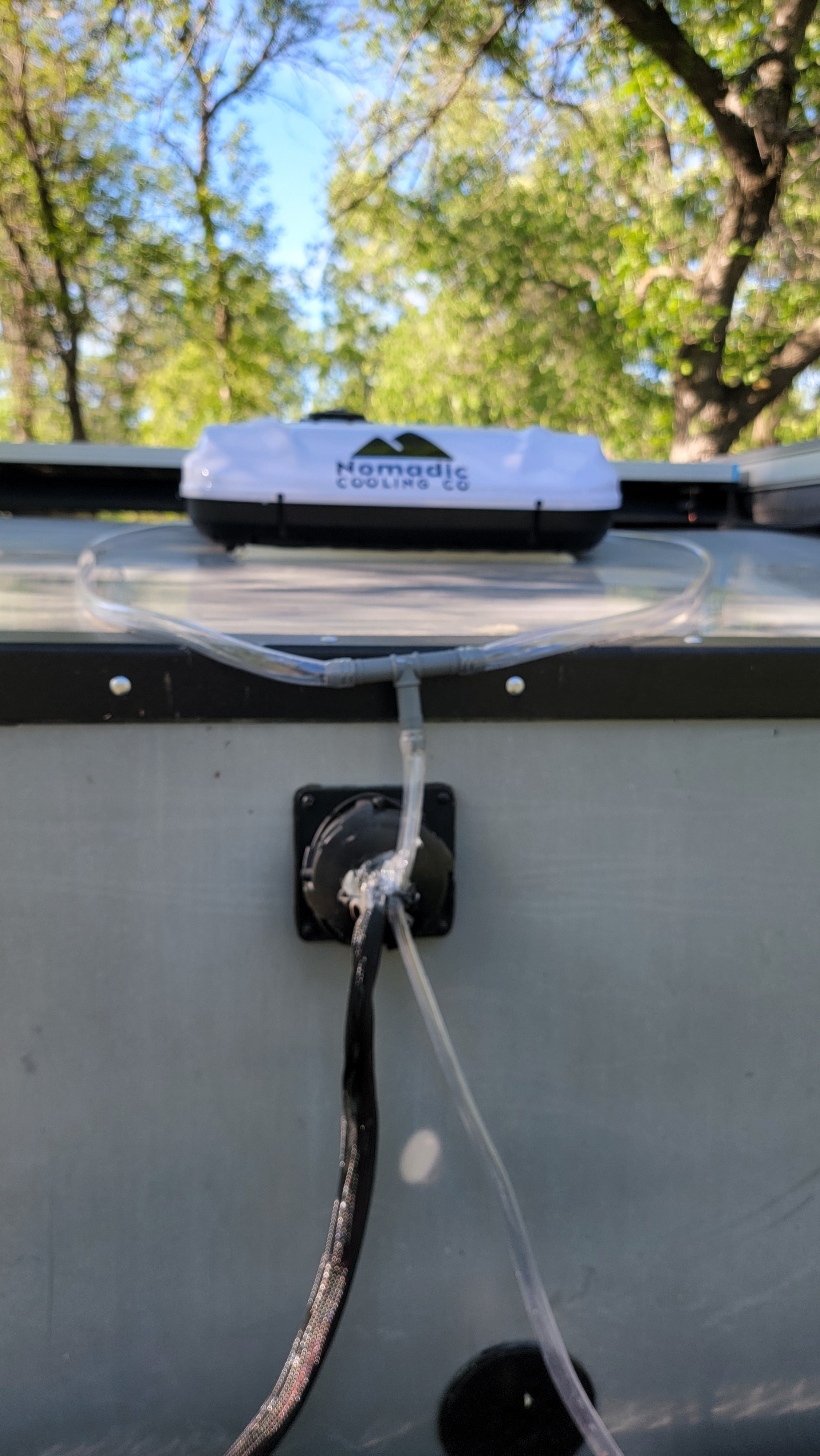

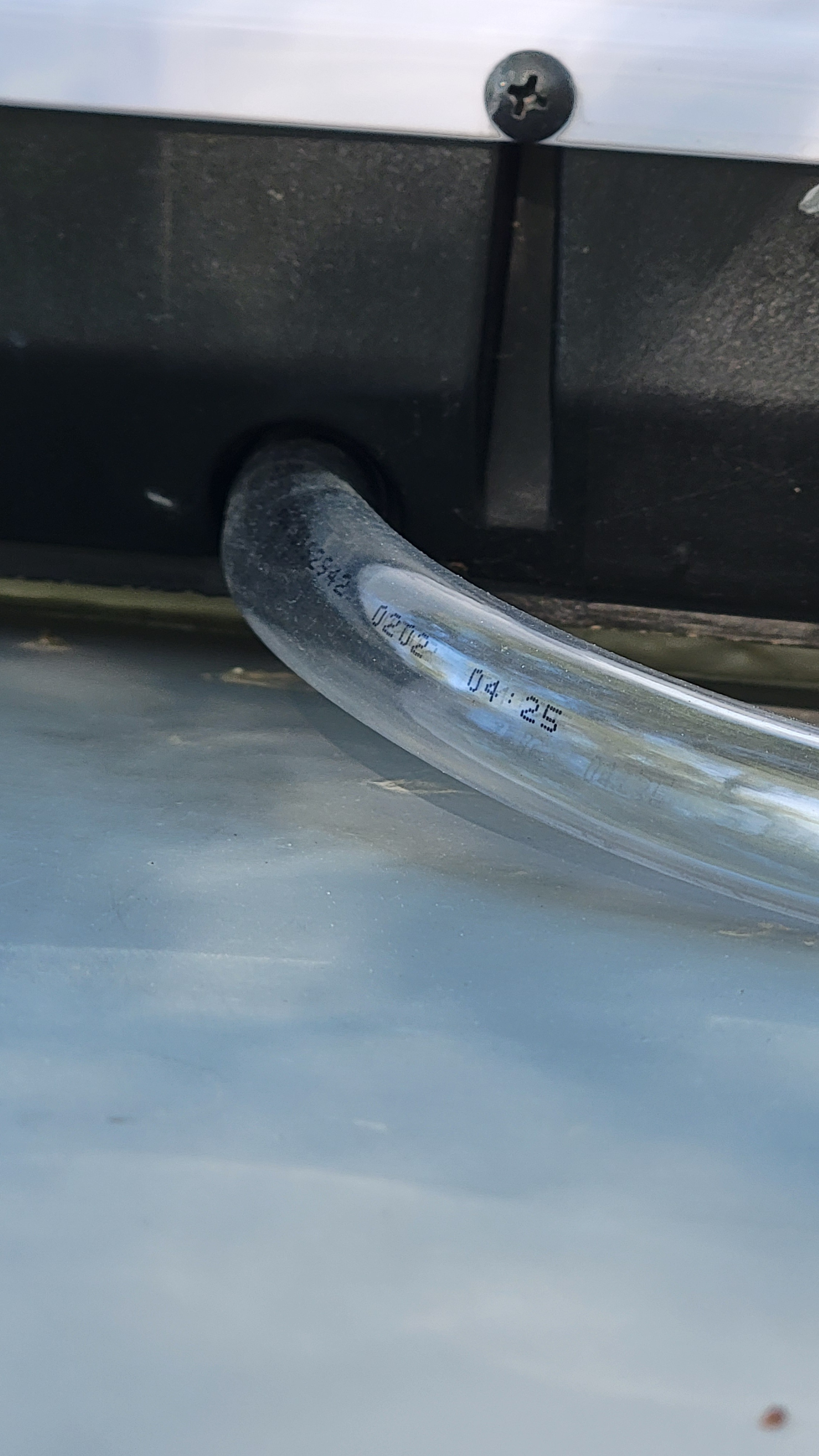

        Greetings,
        We've run the air conditioner 5 days now and have found the condensate to run smoothly out of the front ports (See pic) We added hoses that really take the look of things the wrong direction. But, I didn't want the drainage to run down the camper side staining it. This is working, just looks trashy.
        There is no fan per se, but we found setting the a. conditioner on economy setting the fan will run at what ever setting you choose. We then set the temperature setting just high enough that ac won't kick on, the fan runs all night/day this way. There is no venting in or out like a Maxx fan or Fantastic fan. We accept this as a trade off for ac. It just moved the air inside our camper.
        Hope this helps!
          Possibly better picture.
