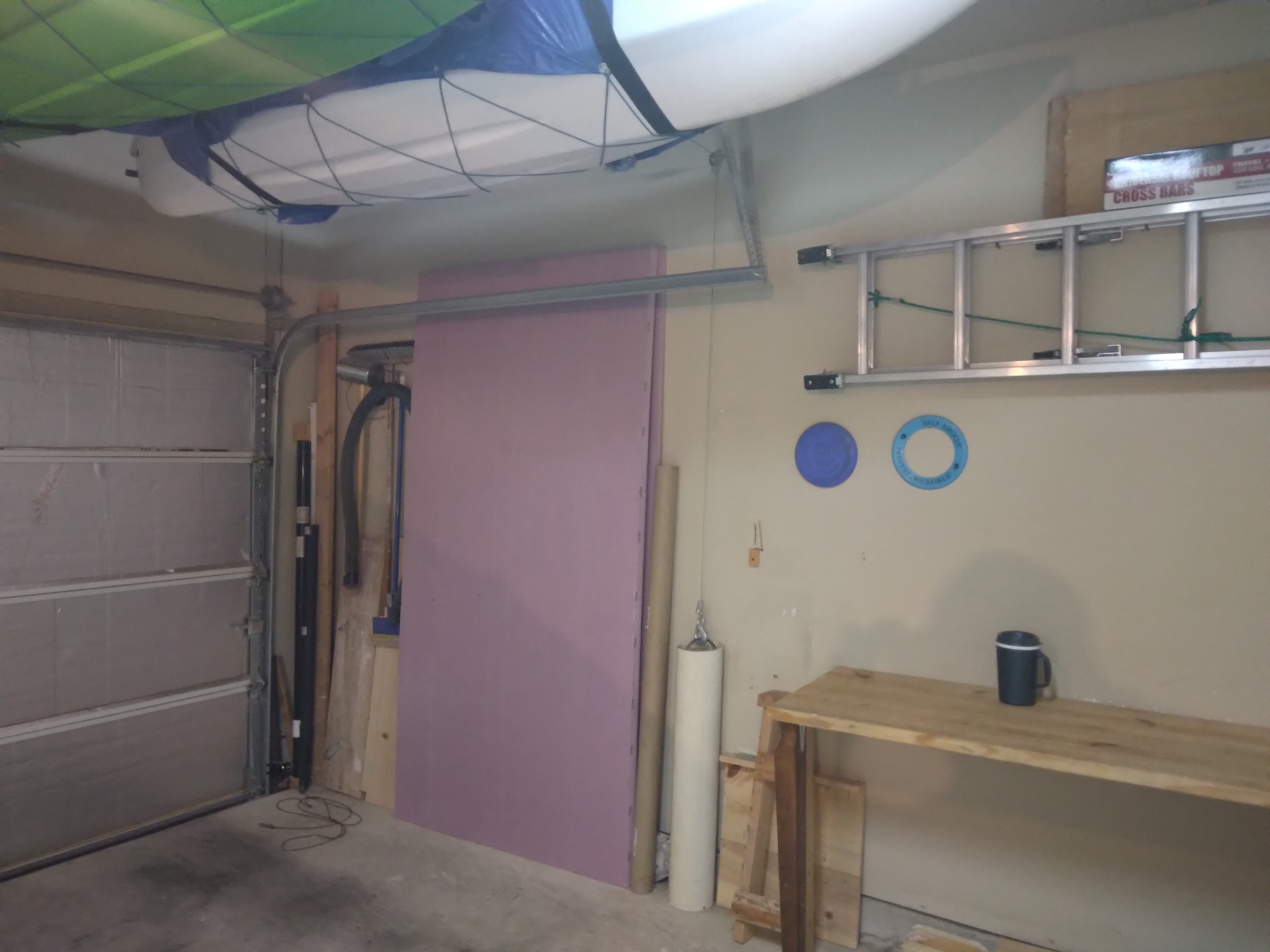

Here's the counterweight; pvc pipe filled with concrete:

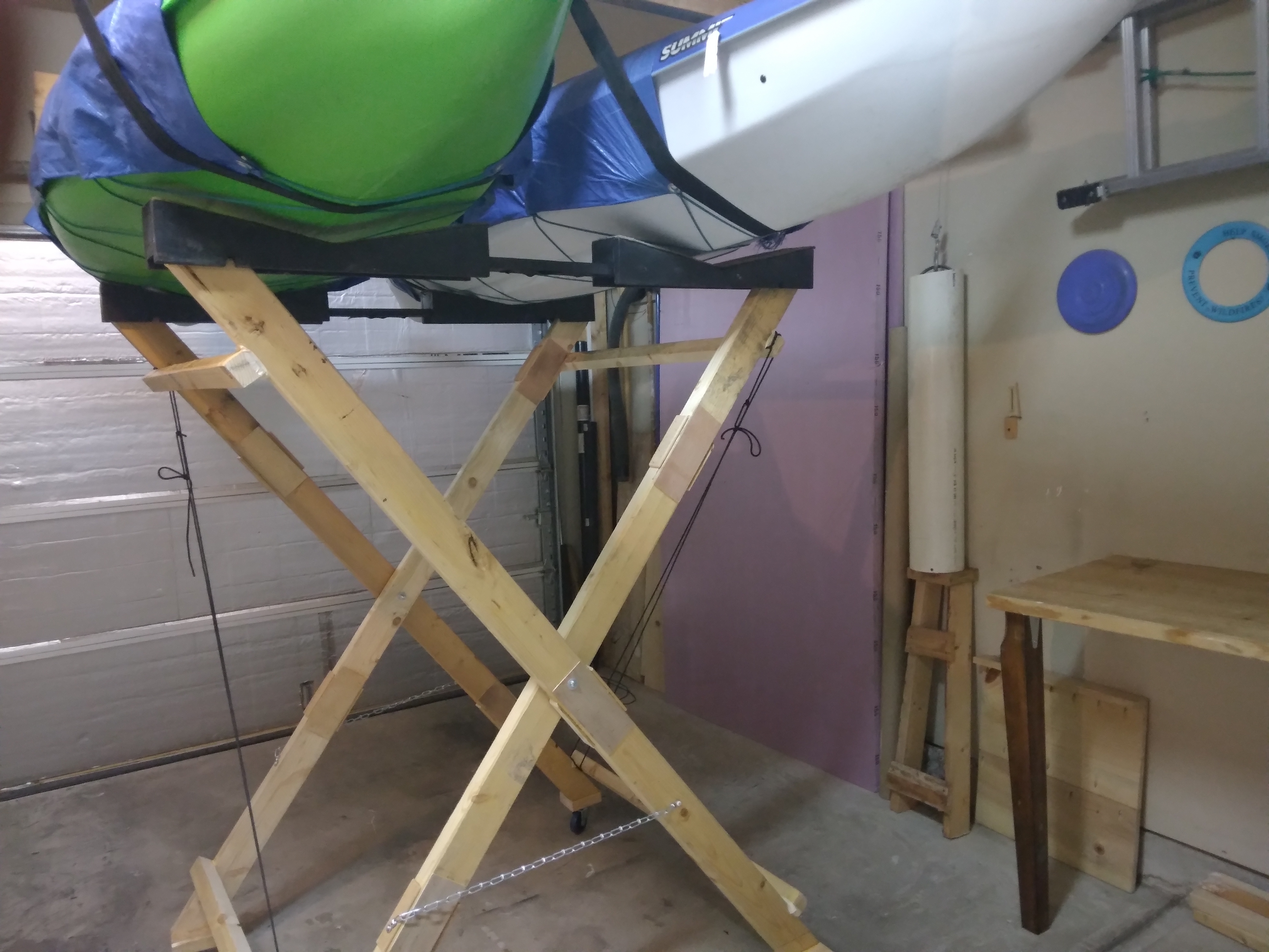

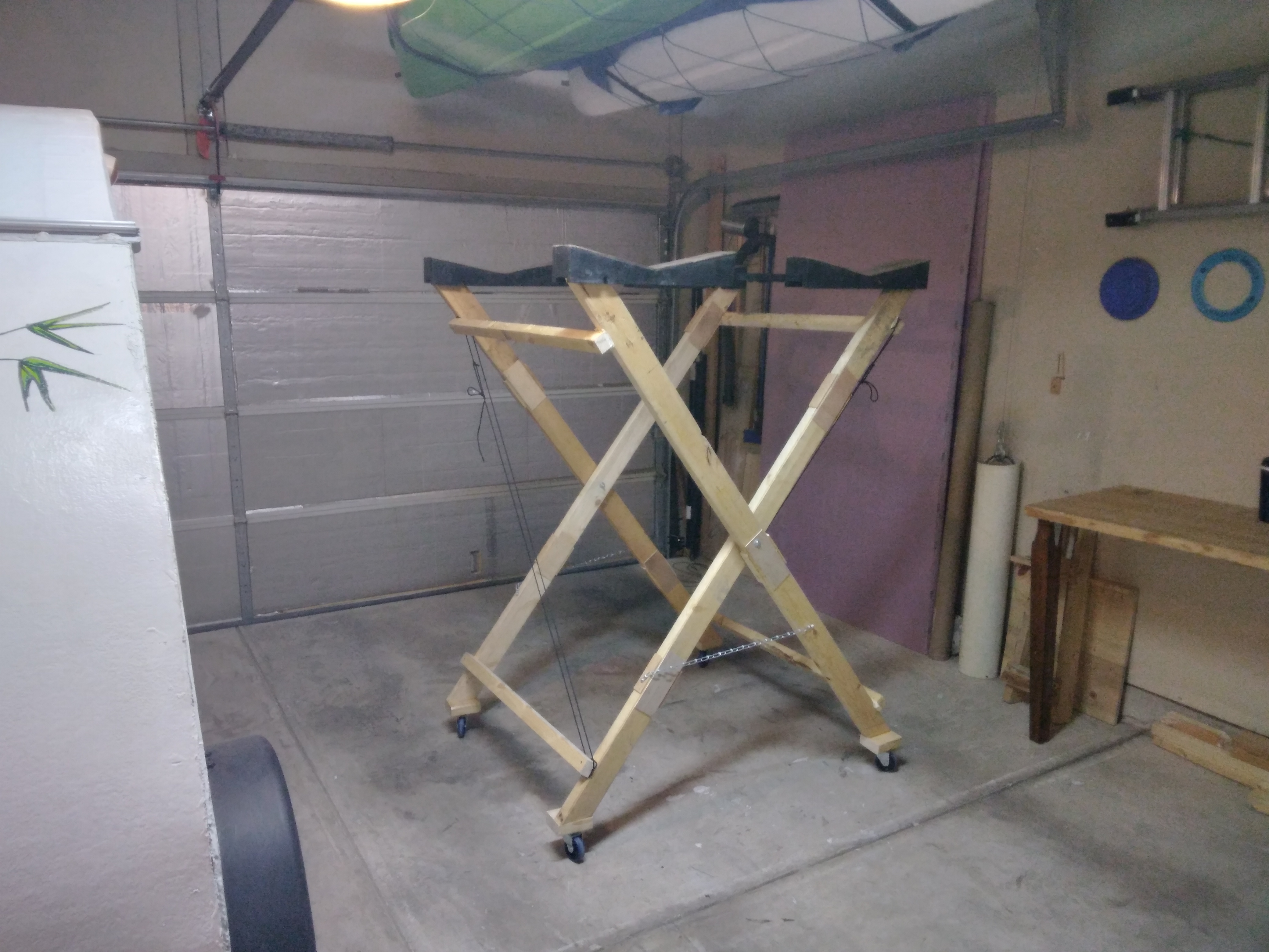

The mover in position to receive (I re-purposed the kayak cradles,the black thingies, I made for the Outback's crossbars):
Trundle lowered:

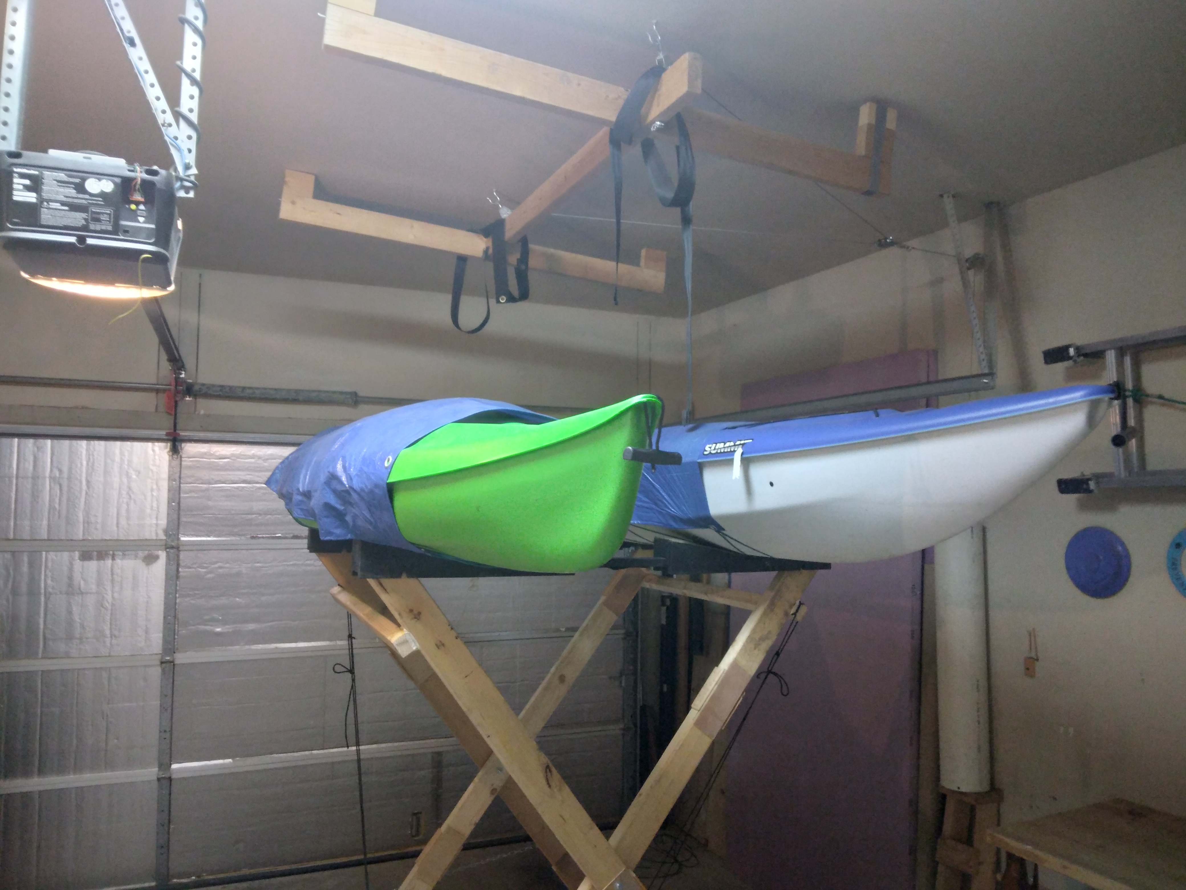

Kayaks on mover:

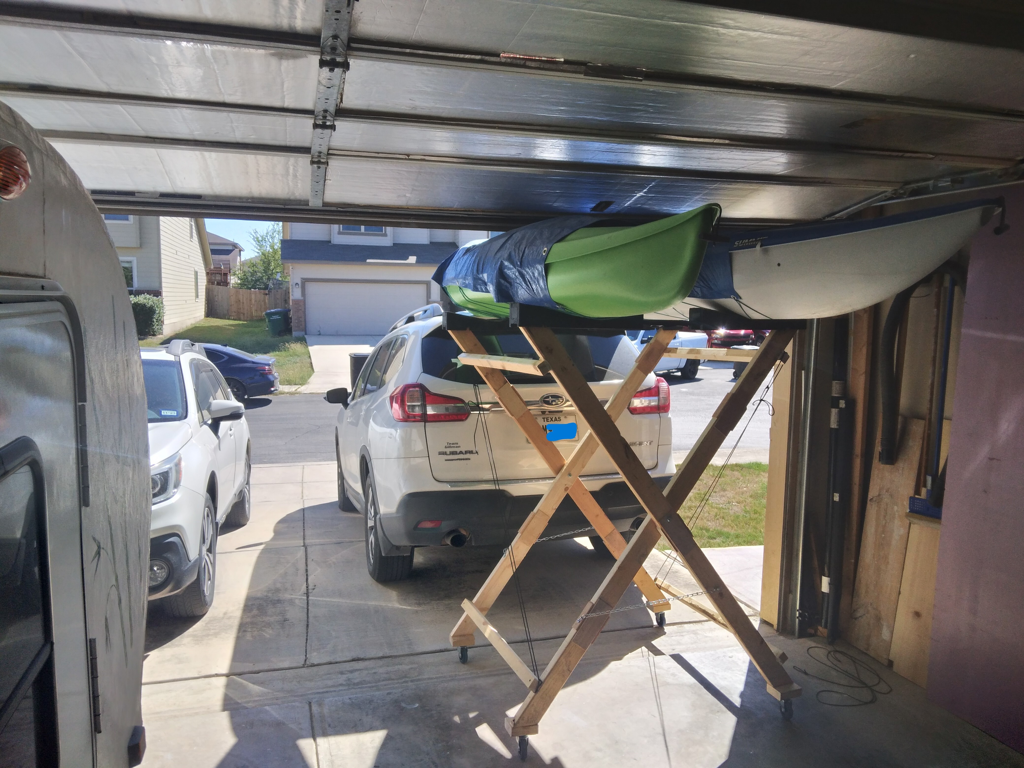

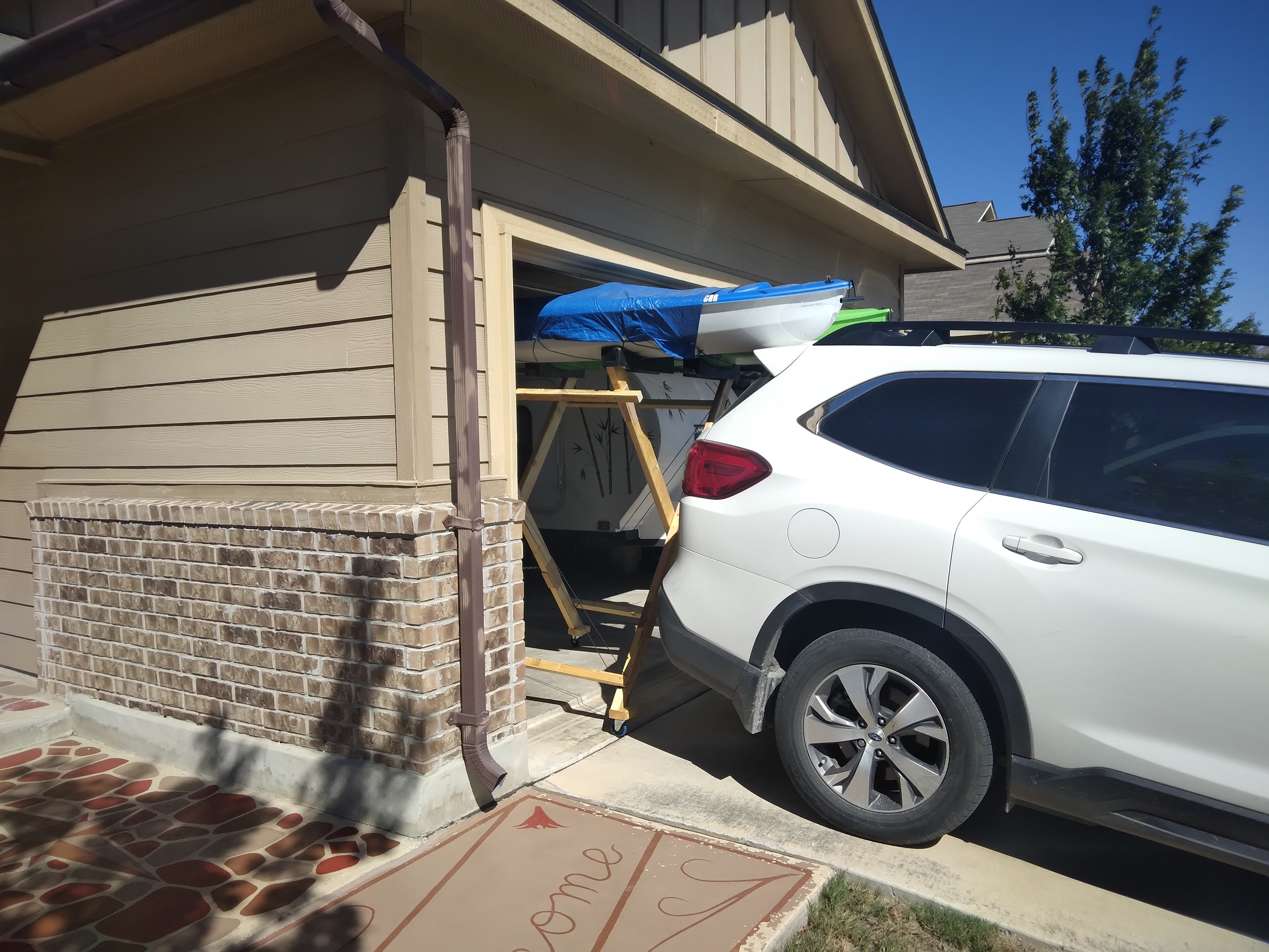

Mover positioned behind vehicle:
Trundle lowered:
Kayaks on mover:
