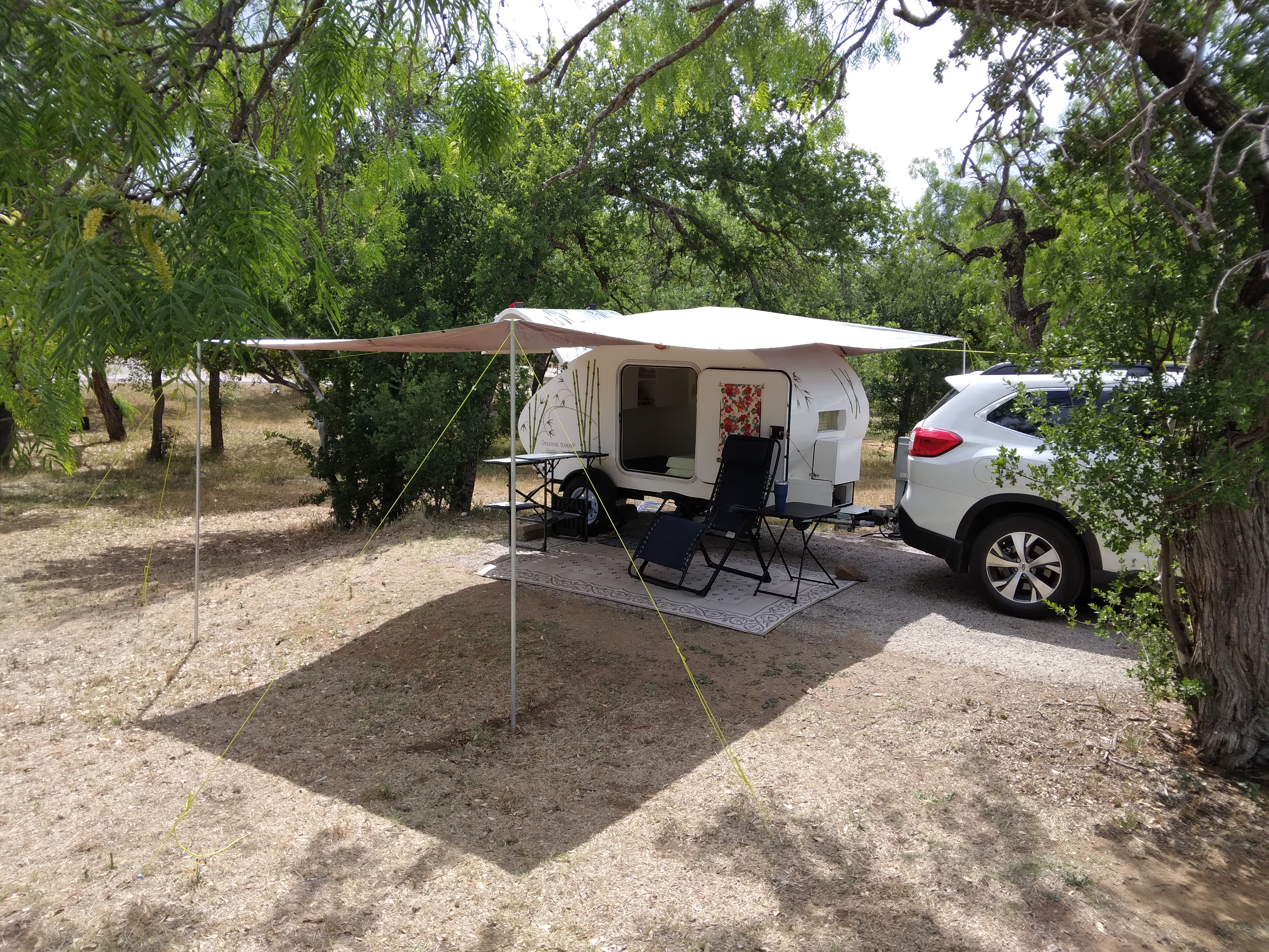

          John,
          Here's my concept for an awning/cover for my homebuilt teardrop. I took 10', 3/4" steel conduit sections and cut them down to 7' lengths, six pieces. I drove wooden plugs in each end, then inserted concrete nails (the ones with the spindle-shaped head) into the top ends. I put a standard 10'x20' tarp's corner grommets over the nails, then place the guy lines over the nails to keep the tarp in place. I made a PVC frame with pool noodle sections on the corners of the frame that fits around the roof vent. That acts as an off-center "pole" to protect the vent cover and the noodle sections protect the tarp and the top of the camper from scuffs. I go 3' over the port side of the 5' wide trailer which gives me 10'x12' of covered area on the starboard side. The 5th and 6th pole are for the "middle" of the long sides of the tarp if I don't have any trees close by. Guy lines are 550 cord from Dollar Tree. Stakes are the 10" nails with the plastic heads. My Inks Lake meet (24-26 Apr) was my 2nd time to set up the tarp and poles. As you know we had a pretty strong system waltz through then. It stood up to estimated 15 to 20 mph winds and had handled 10 to 15 mph winds the time before. Not bad for a home made rig, eh? The pic below is at Inks Lake State Park.
          DJ
          LSCD
          Click image for larger version  Name:	Inks Lake SP Apr 2022.jpg Views:	14 Size:	6.19 MB ID:	20397
