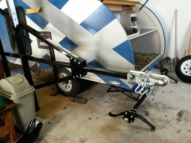

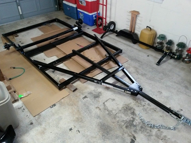

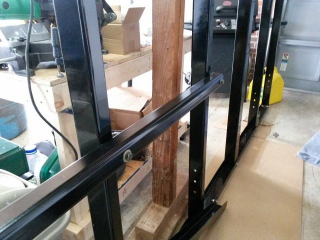

            I had a build thread on TnTTT years ago that had the information: https://www.tnttt.com/viewtopic.php?p=1067349#p1067349
            Basically you flip the coupler mounting plate upside down, which allows you to slide a piece of 2x2x3/16" steel tube through it, and bolt that steel tube to the underside of the first two trailer frame cross members. You also bolt through horizontally through the coupler mounting plate (and the newsteel tube that runs through it) to help stabilize the tongue extension. And then you need to get a replacement coupler made for a 2" tongue.

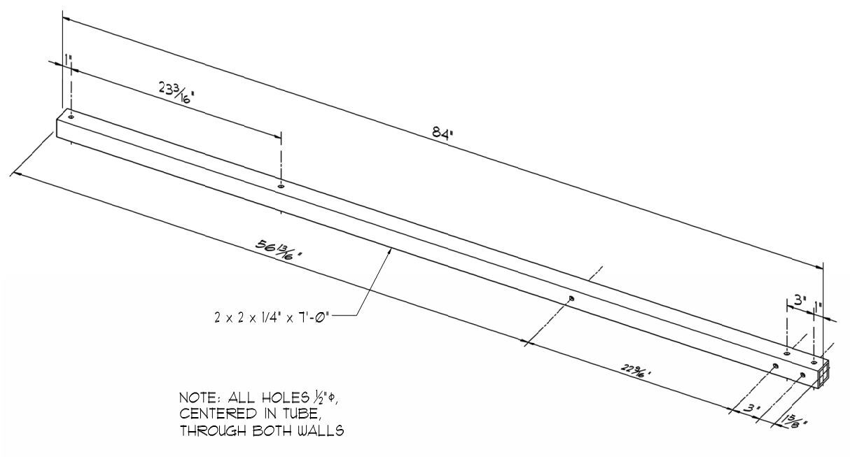

              Thanks Zach. I have read your thread about your build but could not find the length of the tongue extension. I see how you placed the holes for the coupler but not for the placement of the two holes from the left end of the extension. What would be those measurements? Or do I slide the extension into place and mark the holes that way? Thanks !
                Had to dig through my files, but I found the drawing I gave to the metal fab shop that I got the steel tube from. It looks like I got 1/4" steel tube, but 3/16" should be plenty. I took careful measurements of the frame and the coupler to get these dimensions, and then had them drill the holes. A lot easier for them to do it since I was getting the steel from them, and I don't think they charged me hardly anything for the labor. These measurements were specific to the Northern Tool 5x8 trailer, at the time. I have no idea if anything has changed, so it would be best to verify.
                The measurements for the horizontal holes might be a little hard to read. From left to right: 56-13/16" ; 22-9/16" ; 3" ; 1-5/8"
