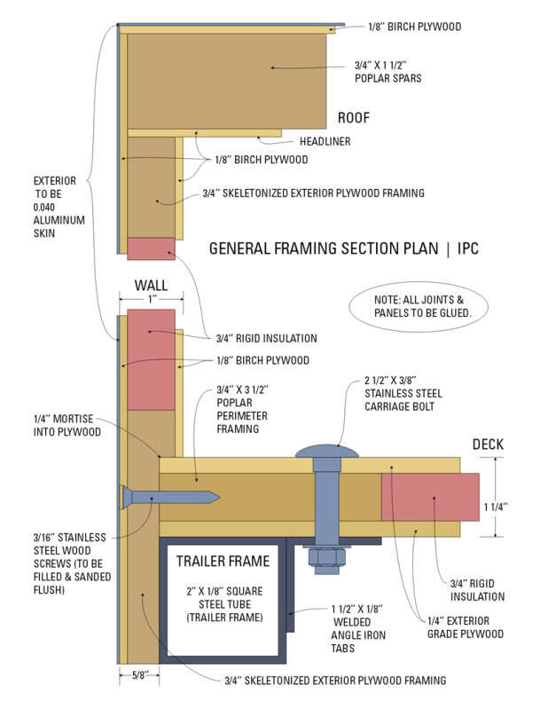

      Dave, yes I am the restorer and pilot of the 1945 J-3. I restored it about 20 years ago. It's a family member. My first question is the construction of the floor. If I make my floor a true 4x8 sheet of 3/4" ply then
      if I set the walls (1/2" ply) down outside the edge, the overall width of the camper is 1 inch wider than 4 feet. if I set my walls on top of the floor then I have an exposed seam at the bottom. I could cut 1 inch off the width of the floor and then set the walls down past the edge. I now have a true 48" outside edge to outside edge. Since I will be using 1/2 ply for the front, top and rear It just makes sense th have the walls no wider than 48" outside to outside for standard width plywood Any thoughts ?
        Sounds like you have a plan! Are you looking at covering in aluminum? Glass? Here's a cut away view to look at.

          Dave, thanks for the graphic. That helps. I’m going to print it and stick it on my garage wall for reference. Matt
