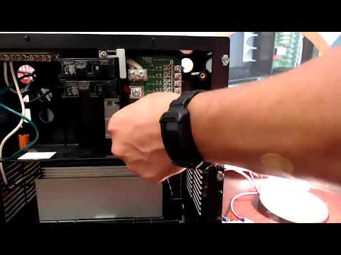

Yes, I hooked my battery up wrong now I have AC power but no DC power. Checked the fusses and replaced one. The fuse that is supposed to protect the converter didn't blow. Any suggestions?
If the 'reverse polarity fuse' didn't blow, then I'm not sure what else to check.
I used WFCO on my second teardrop build and the converter failed after the first year. My buddy had the same experience. I've switched to Progressive Dynamics and never looked back. Progressive Dynamics makes a direct replacement converter for the WFCO system, and its not a difficult swap. I'd have to search for the part numbers if you want to go that route.
