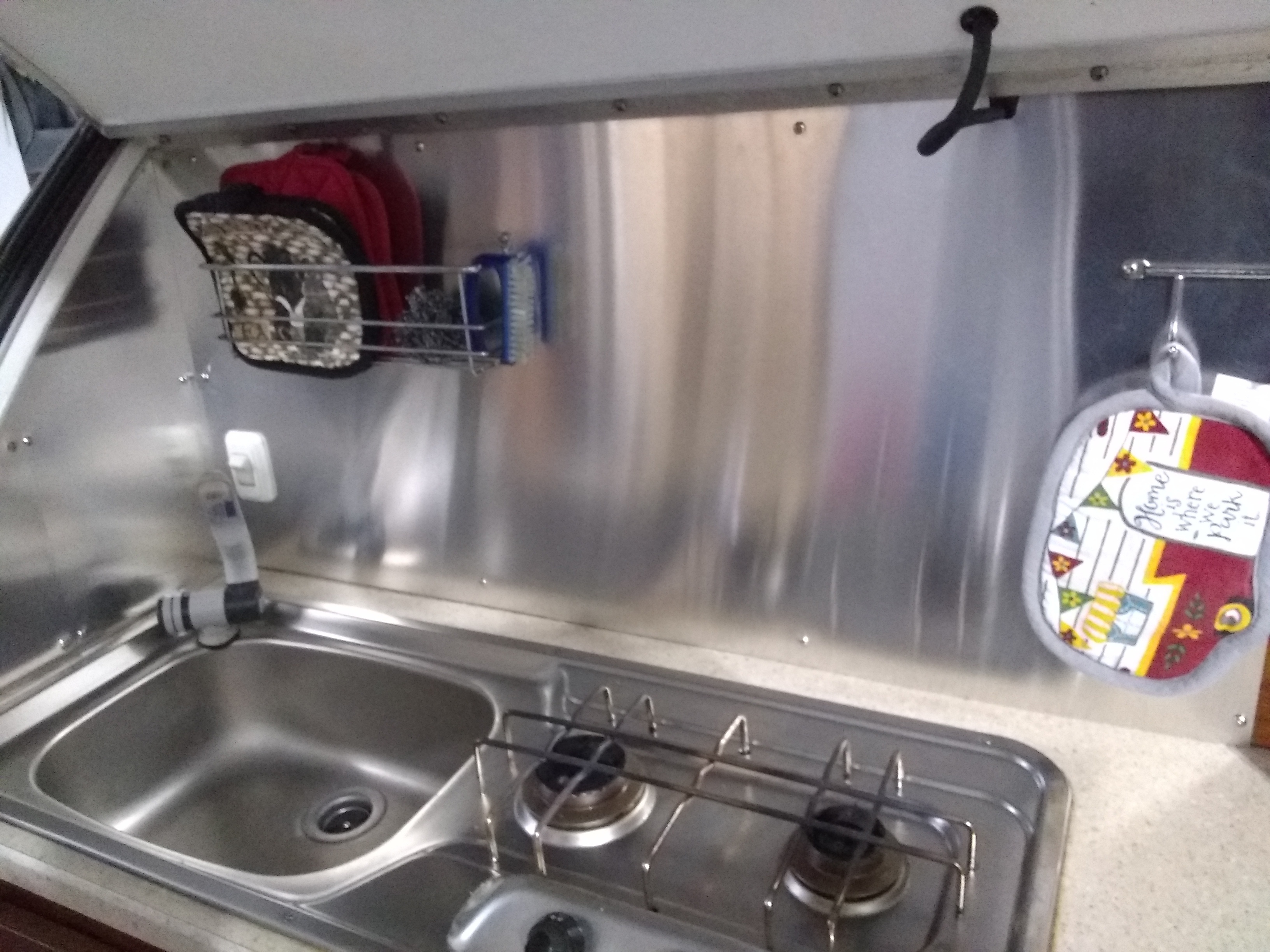

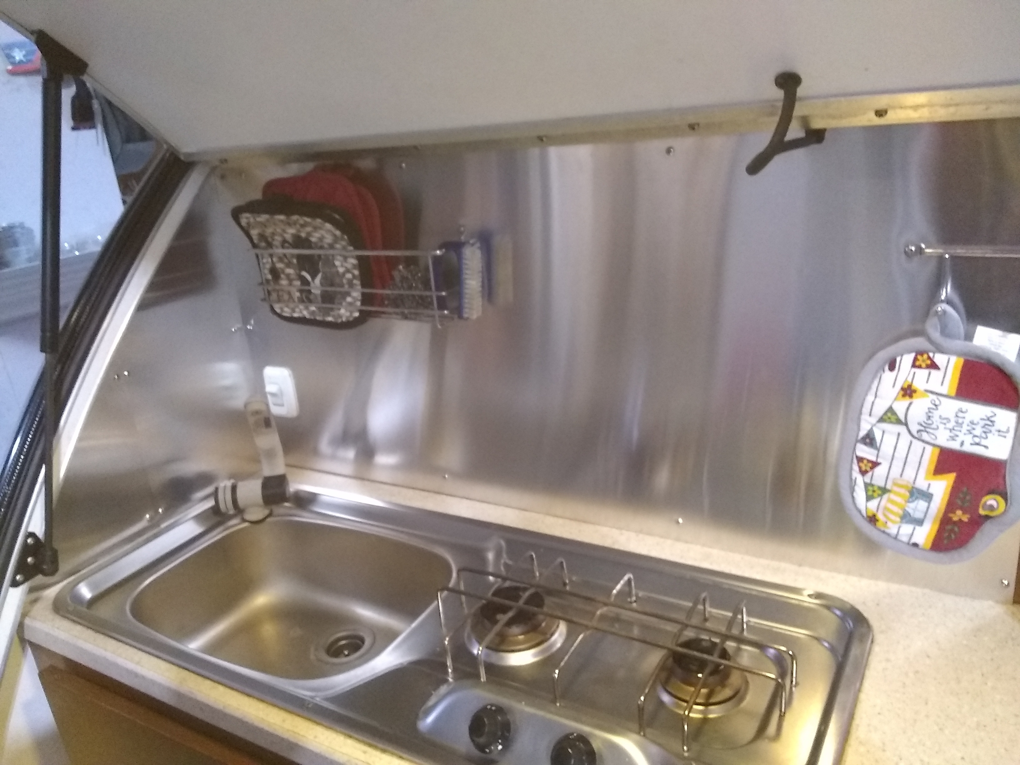

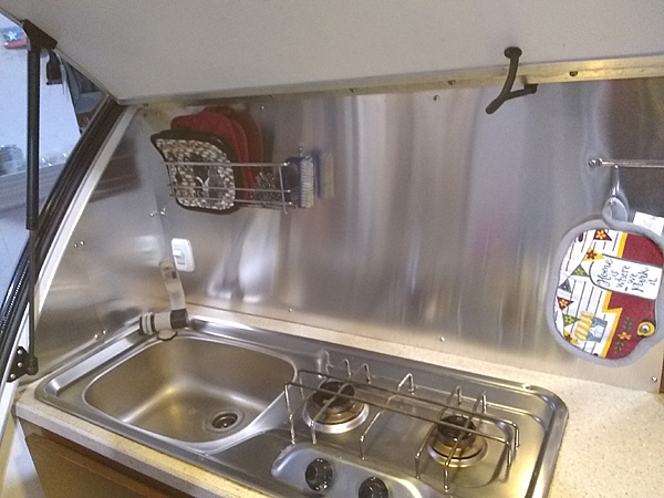

    In past TJ camp outs I've found myself admiring some of the galley upgrades/rehabs I've seen from some of my chapter members and finally did one myself. It only took a few hours and really gave the "kitchen" some diner-style pizzaz!
    It only cost $36 for a sheet of aluminum that I carefully measured and cut by scoring with a box cutter and folding on the cuts. Add a few stainless screws and I now have a shiny new backsplash that should be easy to clean up any cooking splatter! I did take these pics before I ran a bead of clear caulk which cleaned up the edges nicely. Hope you "like" it!
    Next, I'm thinking about pulling the sink/stove top combo unit to remove and replace the old caulking (it's getting kinda dingy). Has anyone done that? Any advice?
