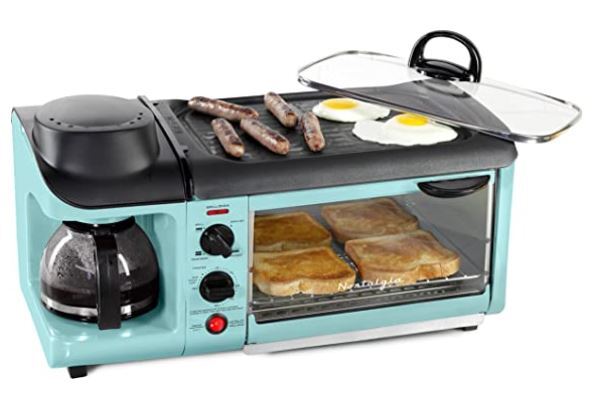

      Is this what you are looking at? https://www.amazon.com/Nostalgia-BSE.../dp/B01F5D10TG
      Click image for larger version  Name:	capture.JPG Views:	0 Size:	29.5 KB ID:	6501
      The comments on the Amazon listing make it sound like that is a 1500 watt device, which means you would not be able to run it on a 1000w inverter.
