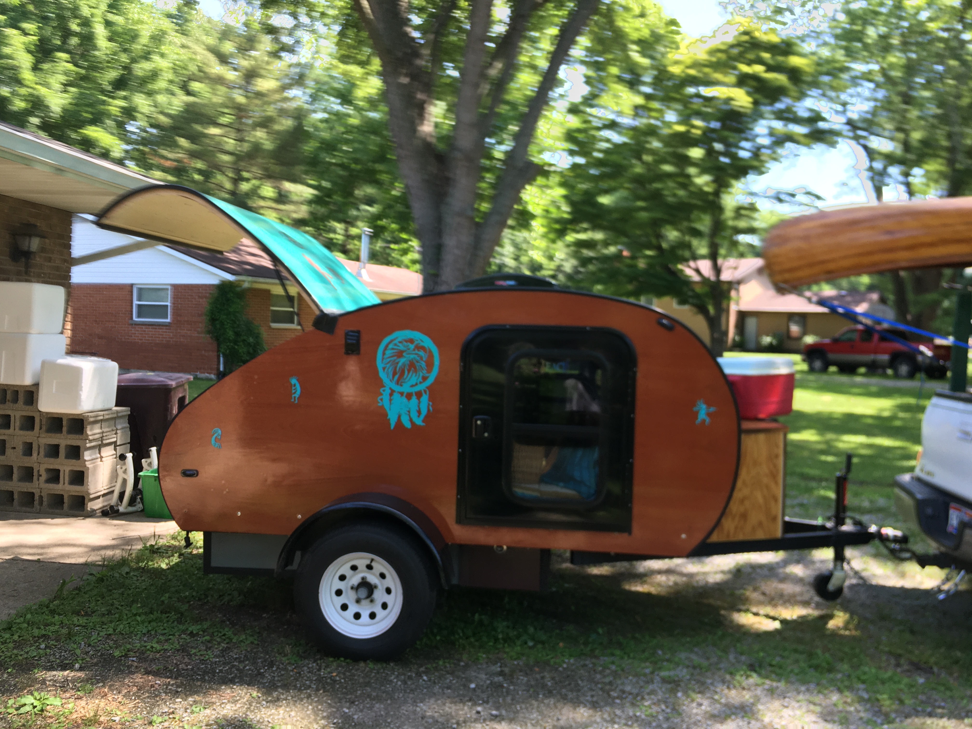

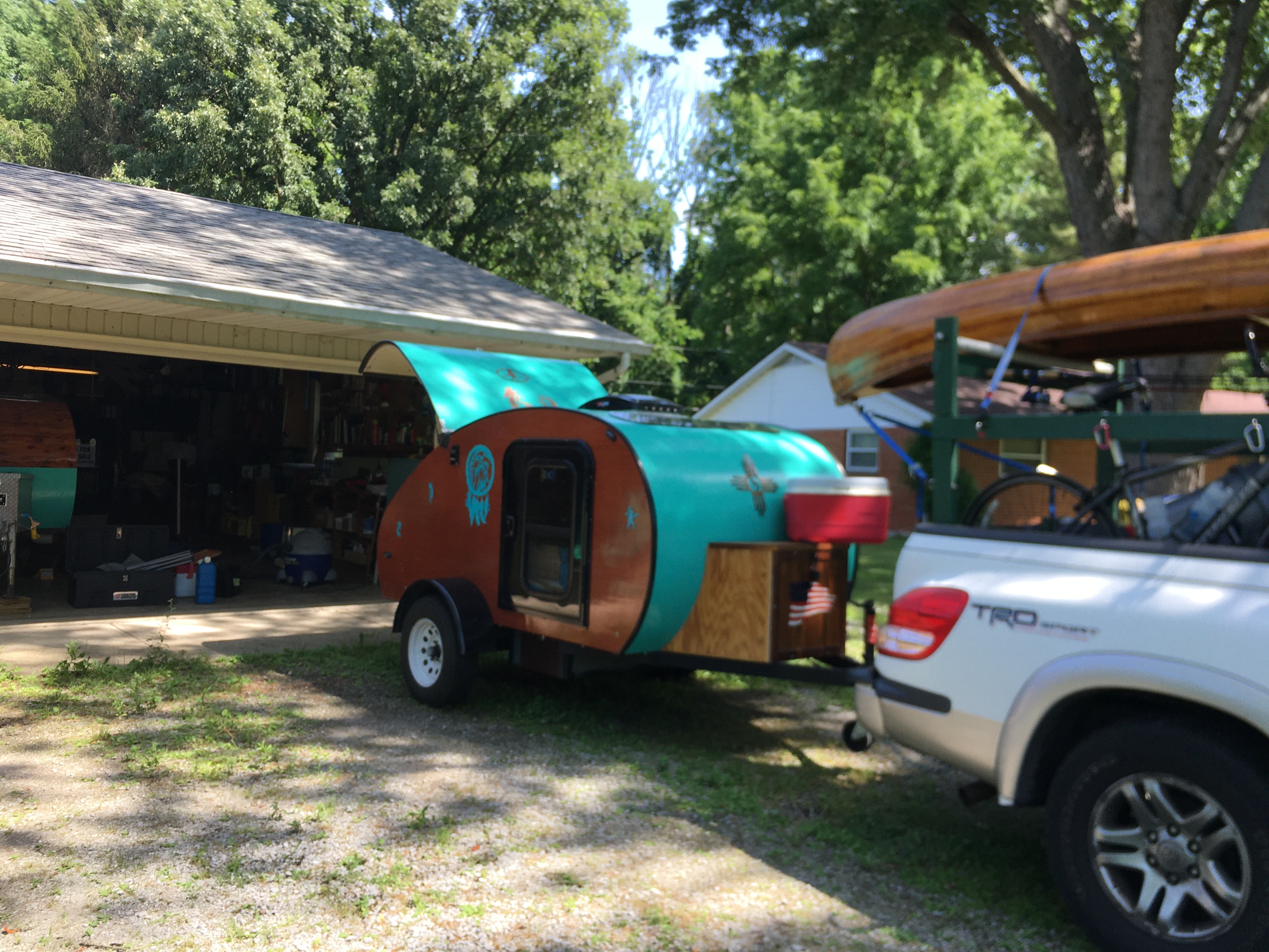

Working on my second Wyoming Woodie teardrop. Had a custom built 5 x 8 trailer frame built. 14 in wheels. About ready to go up with the sides. Cabinetry about finished.
it will bw coated with several coats of resin . topped with spar varnish for ultravilot protection. what you see is 3/4 ply with a mahogany veneer. first trailer had 1/4 cedar strips laid on. we'll see how the veneer works
Rear cabinets almost finished and on the trailer. Plastic laminate applied in the kitchen area. Turquoise paint for the interior cabinets. Plan to get the walls and front cabinets up tomorrow.4 Photos
