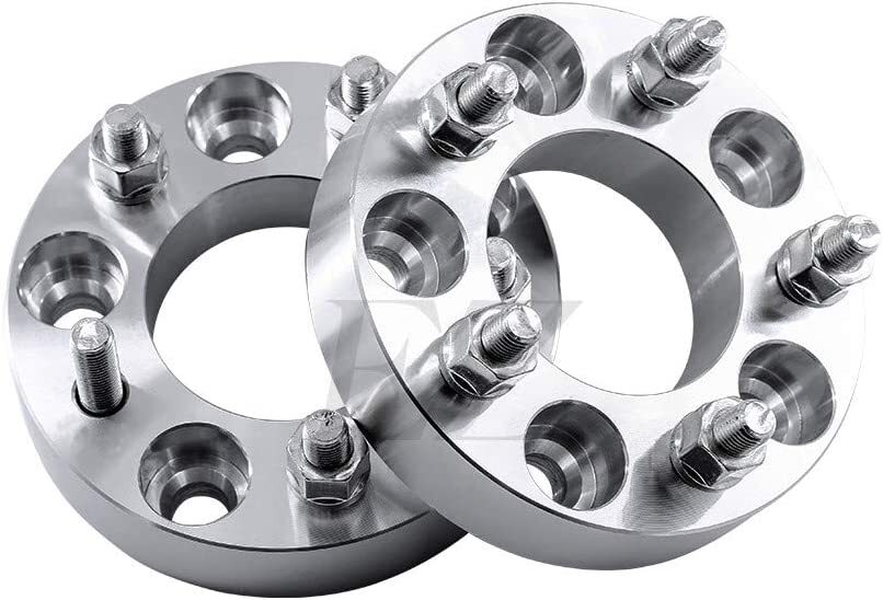

Has anyone else mounted Subaru wheels on their trailer? I'm deep in planning my next teardrop and want to use Subaru wheels (5x100 bolt pattern with 53mm offset). The issue is that 2000lbs trailer hubs are standard 5x4.5" bolt pattern, with a pilot diameter of around 63.5mm (~2.5"). So I need a pair of 5x100 to 5x4.5 wheel hub adapters with minimum 63.5mm center bore.
The last required spec of the adapters is thickness. Since trailer hubs and bearings are designed for 0mm offset wheels, the adapters need to be as close to 53mm thick as possible, to account for the 53mm offset of the Subaru wheel. 50mm seems to be common thickness, and would be close enough. The 3mm difference is pretty negligible for an approximately 800lb trailer on 2000lb bearings.
The thickest adapters that I've come across which meet all the other specs are only 1.25" thick - https://www.amazon.com/dp/B009AEO7MY/
