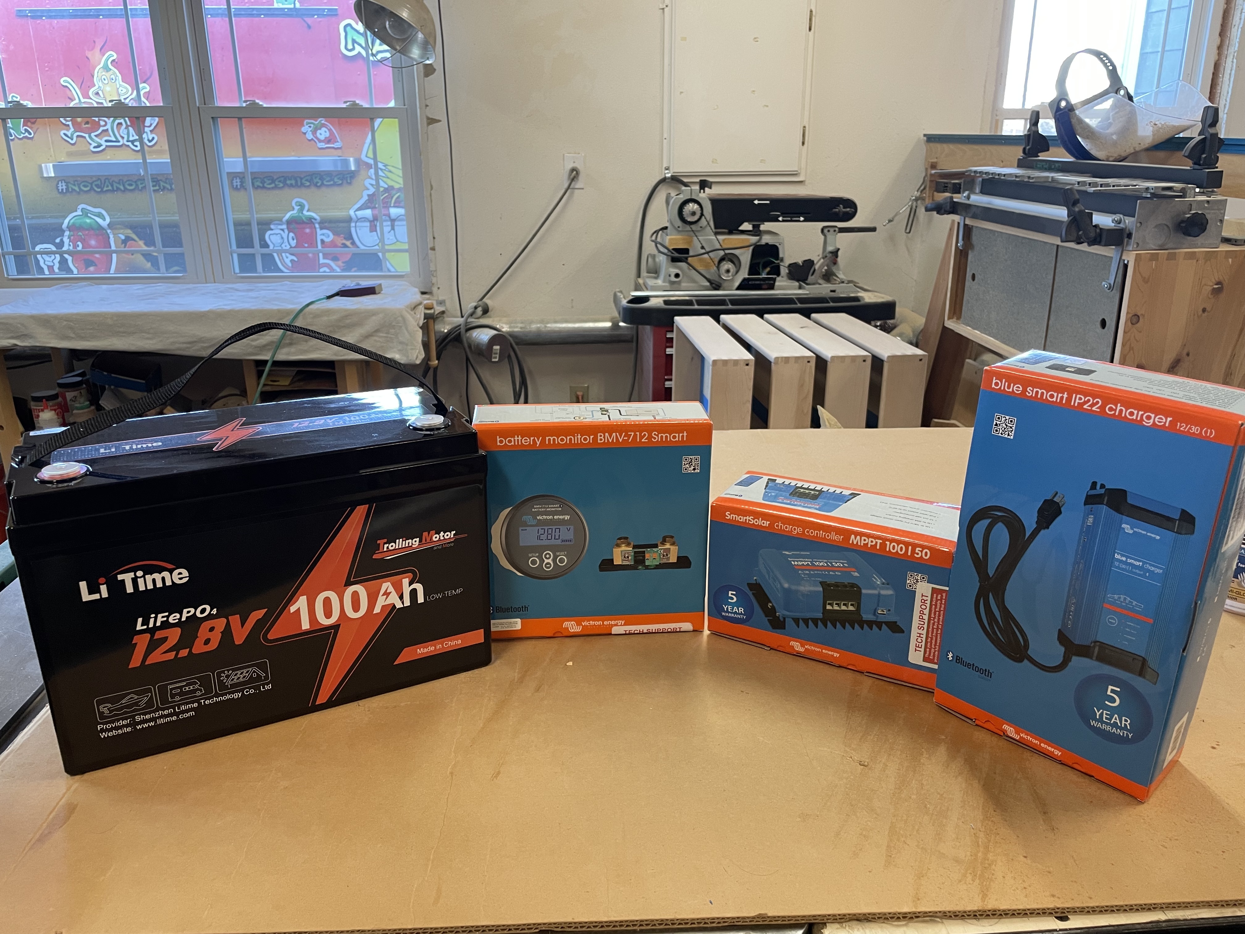

        So this winter I've taking on the job of redoing our complete Electrical including more solar. as for solar power stations I'm a huge fan of Blueitt Solar power stations. I use a EB3A 268.8 Wh on the shelf in our cabin to charge all electronics and maybe a movie in bad weather on the Ipad, in the Galley I have a AC180 1152Wh power station that I use for AC appliances when needed. Currently adding a Renogy 200W panel on the roof with another Portable Blueitti PV 200W panel on the ground in Series if needed. with a 100Ah LiPo4 battery in Galley as well and we can go a couple weeks before I need to worry about Electricity. hers a picture of the equipment Iam getting ready to install. working on wire and fuse size, hopefully have it all installed soon.

          Nice stash! I'm a big fan of Victron. Although I think half my camper budget went to just them. And I've been following reviews on the LiTime batteries since back when they were called AmpreTime. They're on my shopping list but I just haven't bit the bullet yet. Going to pick up two to replace my cheap AGM deep cycles.

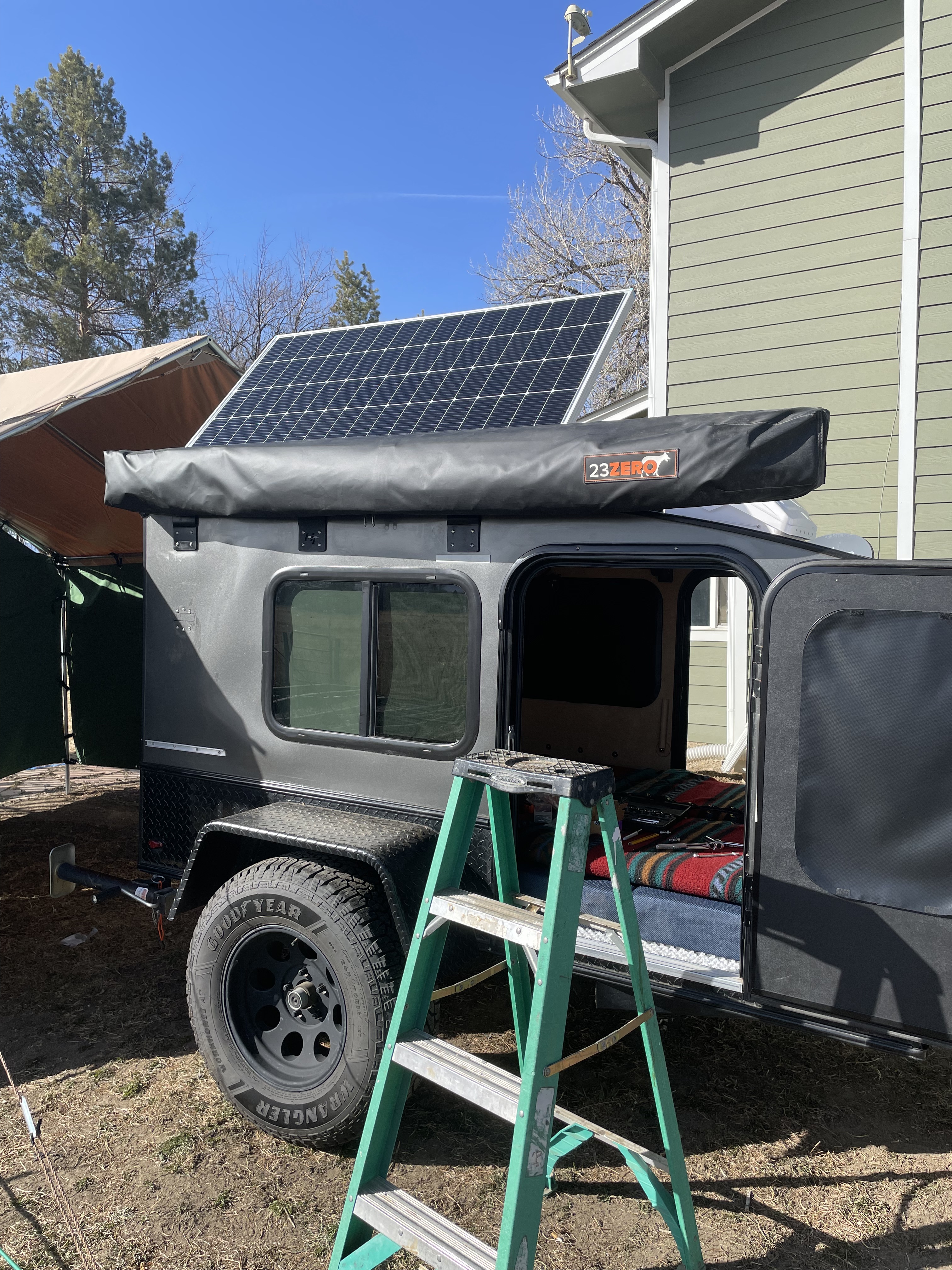

              Might want to look into Blueitti if I was you, more reliable and cost effective. First you need to do a electrical Audit, to find out how much you think your going to need, I would either google it or check YouTube, there a lot of great videos on how to perform your audit. I have the Blueitti EB3A that sits on my shelf in our sleeping area to charge all our electronics its 268.8 Wh Lipo4 battery, we can go a couple weeks plus before I need to charge. My post is above about my upgrade with Electrical in our Hiker Trailer I also installed a Renogy 200W Panel on Tilt Brackets to angle to the sun, which Keeps our LiTime 100AH battery fully charged to run our trailer. as another back up option that I haven't had to use yet is our Blueitti AC180 Solar Generator which has a 1152 Wh Lipo battery in it, essentially equals another 100AH battery. my goal with that is by chance our on board battery gets depleted I can plug our camper into it to run it completely while house battery is re-charging by solar or shore power. It also has 4 AC Plugs that fills our needs on that aspect. I also use a Blueitti PV 200W portable panel that I can deploy on the ground to chase the sun if needed. check out Blueitti.com for package deals. look at there new model AC200L it simplifies things with a RV plug to plug into. If you need help or have any other questions feel free to reach out. Cheers.
